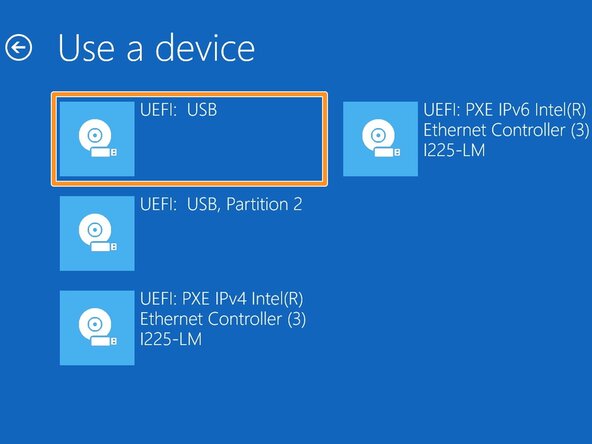

  6. How to Install Linux Mint on a Windows PC, Boot from USB drive: шаг 6, изображение 1 из 3 How to Install Linux Mint on a Windows PC, Boot from USB drive: шаг 6, изображение 2 из 3 How to Install Linux Mint on a Windows PC, Boot from USB drive: шаг 6, изображение 3 из 3
    • If you're using Windows 7, restart the computer and repeatedly press F12, F2, or the key specific to your device to access the boot options menu. Skip the remainder of this step.
    • Open the Settings app and navigate to Update & Security → Recovery then select "Restart now" under Advanced startup.
    • You can also hold the Shift key while clicking Restart in the Start Menu.
    • In Advanced startup navigate to Use a device → UEFI: USB. This will boot the computer from the flash drive.
    • If the USB option doesn't appear in this menu, select Continue to restart the computer and try again.

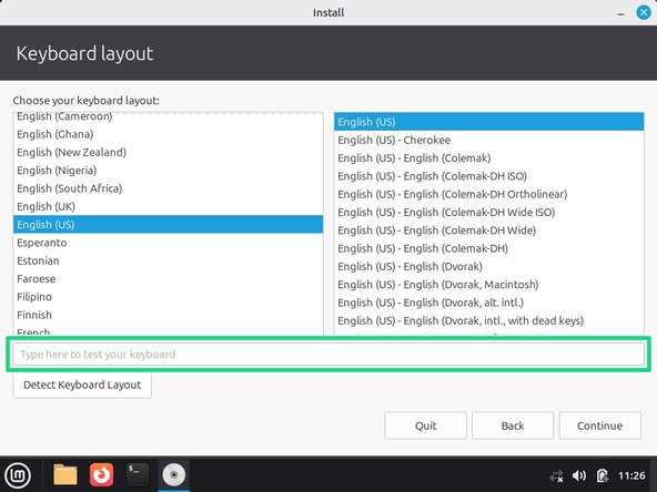

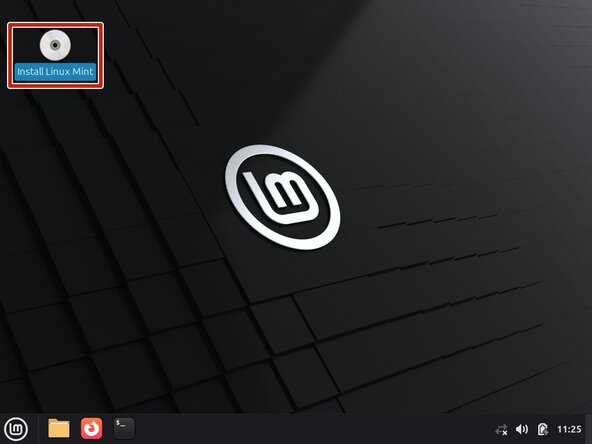

  7. How to Install Linux Mint on a Windows PC, Configure the installer: шаг 7, изображение 1 из 3 How to Install Linux Mint on a Windows PC, Configure the installer: шаг 7, изображение 2 из 3 How to Install Linux Mint on a Windows PC, Configure the installer: шаг 7, изображение 3 из 3
    • The installer will erase the data on the drive or partition you select. Be careful not to accidentally pick one with important data on it.
    • Linux Mint uses a "Live" installer. This means it can run the operating system directly off the USB drive. Take it for a test drive to ensure it's what you expect, but don't judge performance until it's installed on the computer.
    • Select Install Linux Mint to begin the installation.
    • Select the language then click Continue.
    • Select the keyboard layout that matches the computer. It should select it automatically, but use the test field to verify the keys you press input correctly. Click Continue once verified.

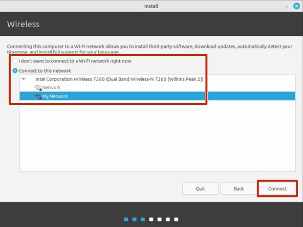

  8. How to Install Linux Mint on a Windows PC, Connect to the internet: шаг 8, изображение 1 из 2 How to Install Linux Mint on a Windows PC, Connect to the internet: шаг 8, изображение 2 из 2
    • If you don't have internet, skip this step and don't check the Install multimedia codecs box (they can be installed later).
    • Connect the computer to a Wi-Fi network or wired connection to get it online. When using a wired connection, this menu may be automatically skipped.
    • Check Install multimedia codecs, then click Continue.

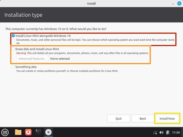

  9. How to Install Linux Mint on a Windows PC, Select installation type: шаг 9, изображение 1 из 2 How to Install Linux Mint on a Windows PC, Select installation type: шаг 9, изображение 2 из 2
    • If you shrank the Windows partition in this step, select the Install Linux Mint alongside Windows option.
    • If you didn't shrink Windows and want to wipe the drive entirely, select Erase disk and install Linux Mint.
    • If you have multiple drives, be careful not to accidentally erase one with important data on it.
    • Click Install Now.
    • If prompted, review the changes and click Continue.

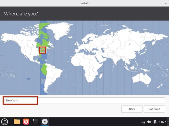

  10. How to Install Linux Mint on a Windows PC, Configure installation: шаг 10, изображение 1 из 2 How to Install Linux Mint on a Windows PC, Configure installation: шаг 10, изображение 2 из 2
    • Select your location/time zone using the interactive map or text field beneath it.
    • Enter your name, computer's name, username, and password. Also select whether to require a password to log in or not (you'll still need it to install software).
    • For additional security, check the Encrypt my home folder box.

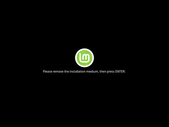

  11. How to Install Linux Mint on a Windows PC, Boot into the new operating system: шаг 11, изображение 1 из 3 How to Install Linux Mint on a Windows PC, Boot into the new operating system: шаг 11, изображение 2 из 3 How to Install Linux Mint on a Windows PC, Boot into the new operating system: шаг 11, изображение 3 из 3
    • Press Restart Now to restart the computer and exit the "Live" installer.
    • Remove the USB drive once prompted, then press Enter to continue.

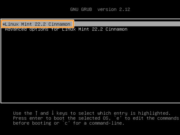

    • Use the arrow keys to select Linux Mint from the GRUB menu and press Enter.
    • If you do nothing, the top option will be automatically selected after a few seconds.
    • Wait for the computer to boot.

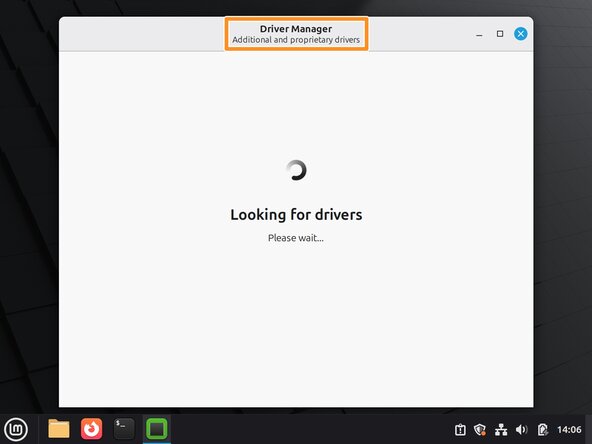

  12. How to Install Linux Mint on a Windows PC, Installation complete: шаг 12, изображение 1 из 3 How to Install Linux Mint on a Windows PC, Installation complete: шаг 12, изображение 2 из 3 How to Install Linux Mint on a Windows PC, Installation complete: шаг 12, изображение 3 из 3
    • Follow the on-screen prompts to get started with the new operating system.
    • Use the Driver Manager program to find any additional drivers you may need for your hardware to work well.

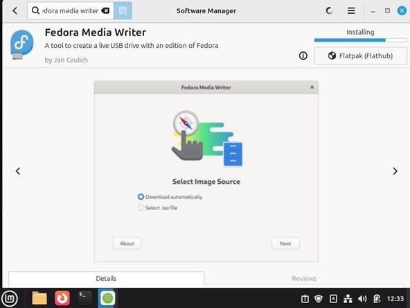

    • Restore the USB drive used for the installer back to normal with Fedora Media Writer for Linux (available from the Software Manager app).
