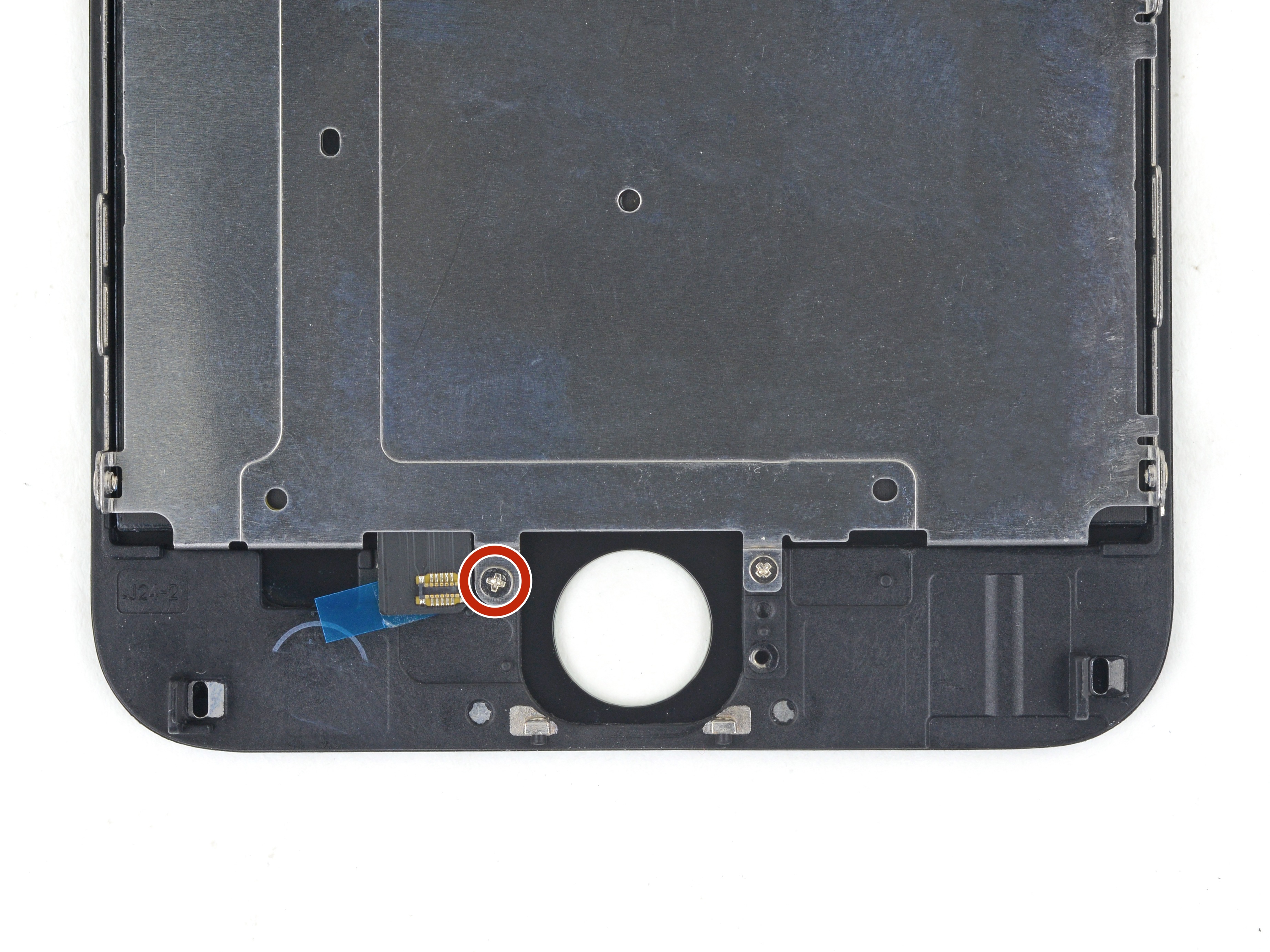

    1. Замена экрана iPhone 6 Plus, Кнопка «Домой» в сборе: шаг 20, изображение 1 из 1
      • Открутите два винта Phillips длиной 1,8 мм, удерживающих кронштейн кнопки «Домой» на передней панели.
      Спросите у FixBot

I have original home screen button, but the panel and home button cable was part of what was damaged on the phone. With that in mind will it still work with original home screen button, but replacement panel?
Pot Kerwin - Ответить Поделиться
This is a tough one. I do not know that you'll be able to salvage the Touch ID functionality of the home button with the connector being damaged. You may need to purchase iPhone 6 and 6 Plus Home Button Assembly and iPhone 6 and 6 Plus Home Button Gasket. This will no longer retain the Touch ID functionality though.
Jeffrey Carpenter - Ответить Поделиться
I will be testing this out myself as soon a I get a new touchID cable/along with the LCD Panel. I did a screen replacement, all went well and works great, however I punctured the TouchID cable when prying it off of the old display.
I ordered a new cable with the panel, as I understand it as long as you have the ORIGINAL TouchID assembly which I do, after replacing the cable it should work!
Cody Crosby - Ответить Поделиться
Instructions are incomplete ! You also have to remove the aluminum plate and the rear camera/speaker assembly.
Also, my touch ID does not work anymore :/ nothing was damaged and plug is connected. Resetting the phone made no difference.
Why would it not work if I used the same Home Button and logic board?
michael8nuts - Ответить Поделиться
hey having the same problem with my touch id.. did you ever find a solution?
bRIZZZZZZZZ - Ответить Поделиться
