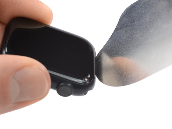

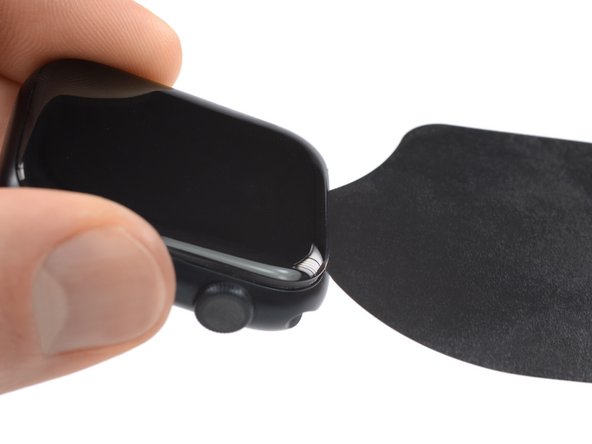

    4. Opening Procedure: шаг 4, изображение 1 из 3 Opening Procedure: шаг 4, изображение 2 из 3 Opening Procedure: шаг 4, изображение 3 из 3
      • Take your time and work carefully to avoid scratching the watch body with your iFlex.
      • Don't insert the iFlex more than 1/16th of an inch (~2 mm) to avoid damaging the force touch sensor.
      • Insert the iFlex into the thin gap between the display and frame at the edge adjacent to the digital crown.
      • Tilt the iFlex down to pry the display open slightly and create a gap between the screen and the watch body.
