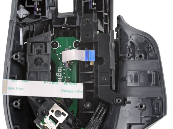

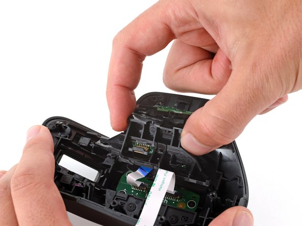

    1. Logitech MX Master 3S Top Shell Replacement, Disconnect the horizontal scroll wheel assembly: шаг 12, изображение 1 из 3 Logitech MX Master 3S Top Shell Replacement, Disconnect the horizontal scroll wheel assembly: шаг 12, изображение 2 из 3 Logitech MX Master 3S Top Shell Replacement, Disconnect the horizontal scroll wheel assembly: шаг 12, изображение 3 из 3
      • Lay the top shell upside down on your work surface.
      • Use the flat end of a spudger to push out the plastic latch on the connector near the right side of the shell.
      • You should feel the latch pop into the unlocked position. Don't push too far, or the latch may come completely off the connector.
      • Use tweezers or your fingers to gently pull the cable straight up and out of its socket.
      • The cable should come out easily. If you feel any resistance, push the latch out a little more and try again.

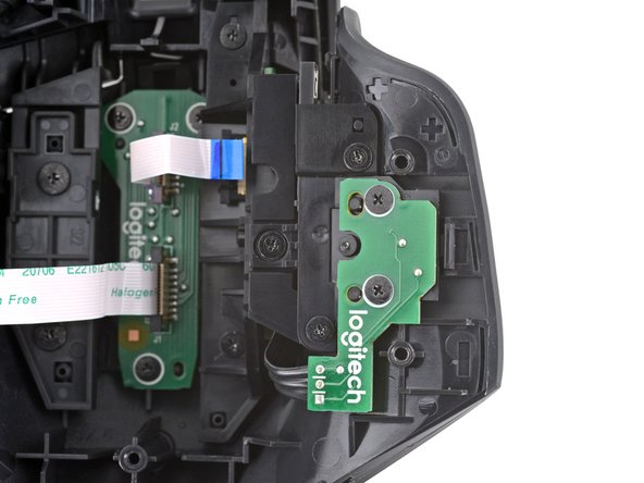

    2. Logitech MX Master 3S Top Shell Replacement, Unfasten the horizontal scroll wheel assembly: шаг 13, изображение 1 из 2 Logitech MX Master 3S Top Shell Replacement, Unfasten the horizontal scroll wheel assembly: шаг 13, изображение 2 из 2
      • Use a Phillips screwdriver to remove the three 3.5 mm‑long screws securing the gesture button board assembly to the underside of the thumb rest.
      • Don't remove the two smaller screws in the board itself.
      Спросите у FixBot
      Добавить комментарий

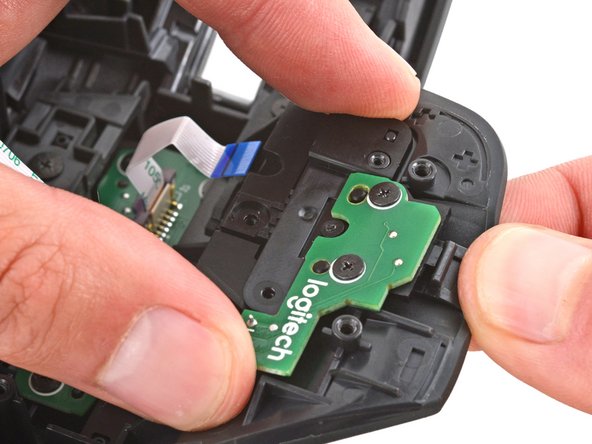

    3. Logitech MX Master 3S Top Shell Replacement, Unclip the gesture button board: шаг 14, изображение 1 из 3 Logitech MX Master 3S Top Shell Replacement, Unclip the gesture button board: шаг 14, изображение 2 из 3 Logitech MX Master 3S Top Shell Replacement, Unclip the gesture button board: шаг 14, изображение 3 из 3
      • Don't try to fully remove the gesture button board assembly. It'll be removed together with the horizontal scroll wheel assembly in a few steps.
      • Push down the outer edge of the thumb rest to unclip the right edge of the gesture button board assembly.
      • Lift the assembly off its alignment posts and pull it towards the center of the shell.
      Спросите у FixBot

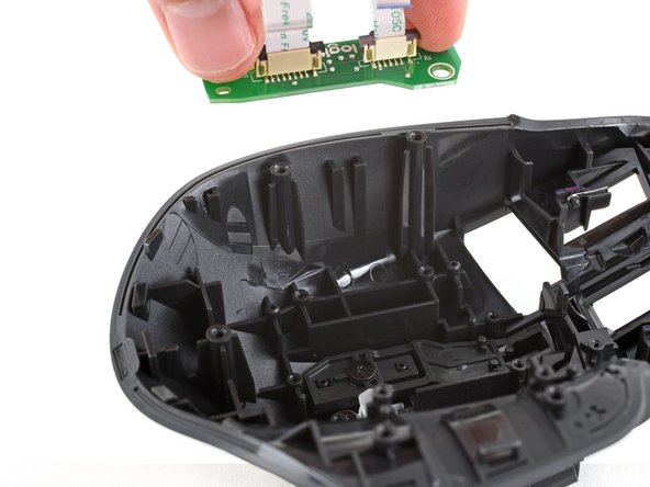

    4. Logitech MX Master 3S Top Shell Replacement, Remove the horizontal scroll wheel assembly screws: шаг 15, изображение 1 из 2 Logitech MX Master 3S Top Shell Replacement, Remove the horizontal scroll wheel assembly screws: шаг 15, изображение 2 из 2
      • Use a Phillips screwdriver to remove the two 3.5 mm‑long screws securing the horizontal scroll wheel assembly.
      Спросите у FixBot
    5. Logitech MX Master 3S Top Shell Replacement, Remove the horizontal scroll wheel assembly: шаг 16, изображение 1 из 3 Logitech MX Master 3S Top Shell Replacement, Remove the horizontal scroll wheel assembly: шаг 16, изображение 2 из 3 Logitech MX Master 3S Top Shell Replacement, Remove the horizontal scroll wheel assembly: шаг 16, изображение 3 из 3
      • Removing the horizontal scroll wheel assembly is tricky and may take a few tries—be patient and work slowly.
      • Firmly secure the top shell with one hand.
      • Use your free hand to rotate the horizontal scroll wheel assembly away from the shell and lift to remove it.
      • During reassembly:
      • Make sure the cables in the center of the shell are out of the way so they don't get trapped under the horizontal scroll wheel assembly.
      • Put the assembly back into place so the horizontal scroll wheel and side buttons go into their slots and the plastic housing's circular cutouts go over their pegs.

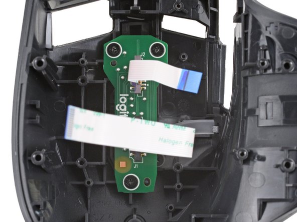

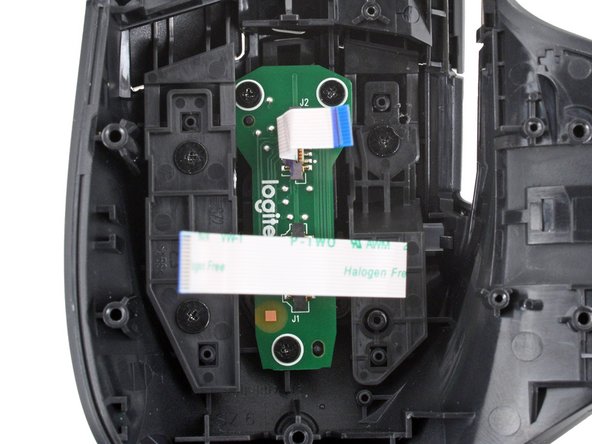

    8. Logitech MX Master 3S Top Shell Replacement, Remove the scroll mode board: шаг 19, изображение 1 из 2 Logitech MX Master 3S Top Shell Replacement, Remove the scroll mode board: шаг 19, изображение 2 из 2
      • Use a Phillips screwdriver to remove the three 3.5 mm‑long screws securing the scroll mode button board.
      Спросите у FixBot
    9. Logitech MX Master 3S Top Shell Replacement: шаг 20, изображение 1 из 2 Logitech MX Master 3S Top Shell Replacement: шаг 20, изображение 2 из 2
      • Use your fingers to gently lift and remove the scroll mode button board.

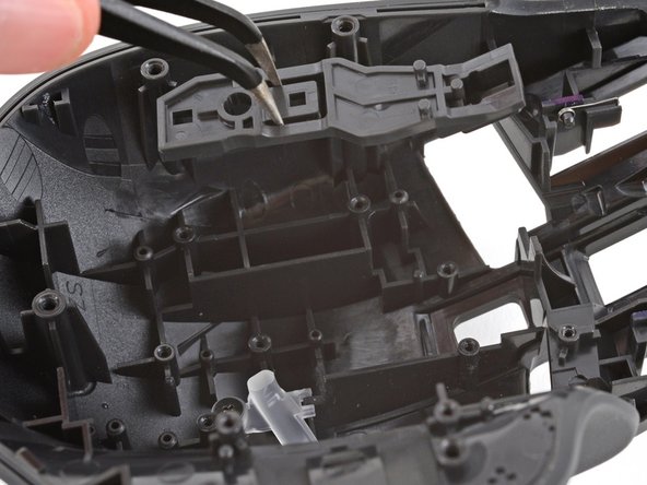

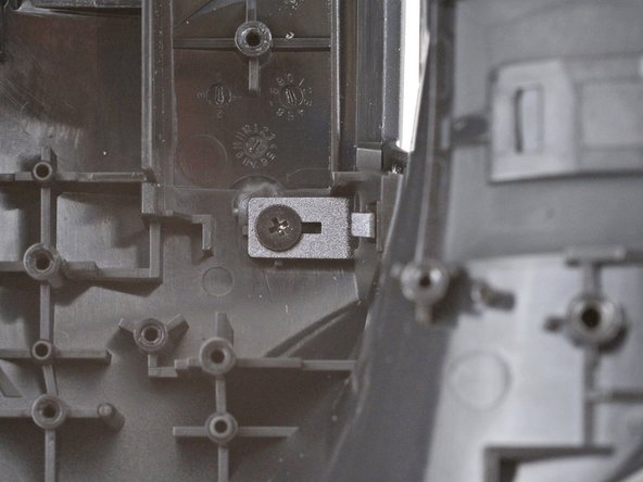

    10. Logitech MX Master 3S Top Shell Replacement, Remove the scroll mode button: шаг 21, изображение 1 из 2 Logitech MX Master 3S Top Shell Replacement, Remove the scroll mode button: шаг 21, изображение 2 из 2
      • Use a Phillips screwdriver to remove the 3.1 mm‑long screw securing the scroll mode button.
      Спросите у FixBot
    11. Logitech MX Master 3S Top Shell Replacement: шаг 22, изображение 1 из 2 Logitech MX Master 3S Top Shell Replacement: шаг 22, изображение 2 из 2
      • Use tweezers or your fingers to lift and remove the scroll mode button.

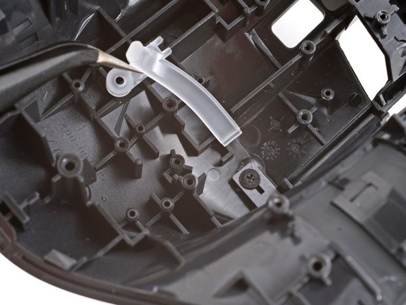

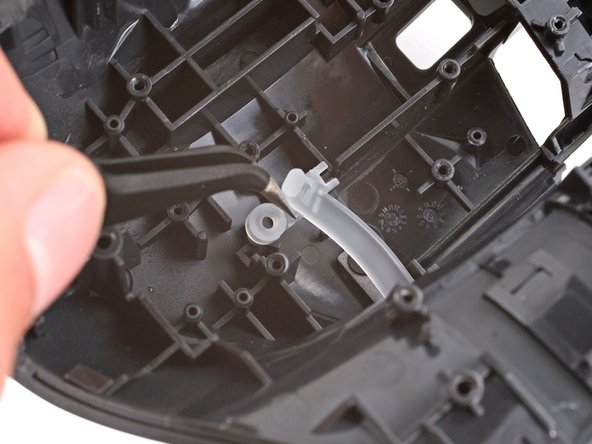

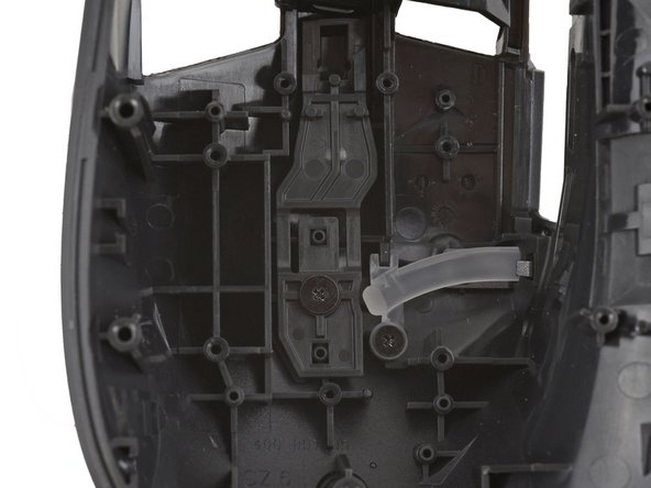

    12. Logitech MX Master 3S Top Shell Replacement, Remove the battery status indicator: шаг 23, изображение 1 из 2 Logitech MX Master 3S Top Shell Replacement, Remove the battery status indicator: шаг 23, изображение 2 из 2
      • Use a Phillips screwdriver to remove the 3.5 mm‑long screw securing the battery status indicator.
      Спросите у FixBot
    13. Logitech MX Master 3S Top Shell Replacement: шаг 24, изображение 1 из 3 Logitech MX Master 3S Top Shell Replacement: шаг 24, изображение 2 из 3 Logitech MX Master 3S Top Shell Replacement: шаг 24, изображение 3 из 3
      • Use tweezers or your fingers to lift the battery status indicator off its post and remove it.
      • During reassembly, insert the indicator into its slot on the edge of the shell and then lower it into place so the screw hole goes onto its post.

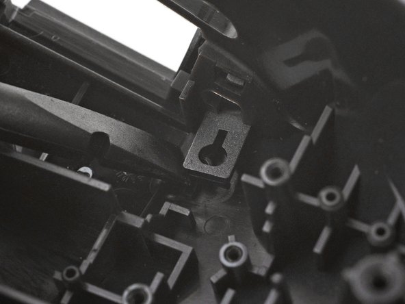

    14. Logitech MX Master 3S Top Shell Replacement, Remove the battery status indicator housing: шаг 25, изображение 1 из 2 Logitech MX Master 3S Top Shell Replacement, Remove the battery status indicator housing: шаг 25, изображение 2 из 2
      • Use a Phillips screwdriver to remove the 3.4 mm‑long screw securing the battery status indicator housing.
      Спросите у FixBot

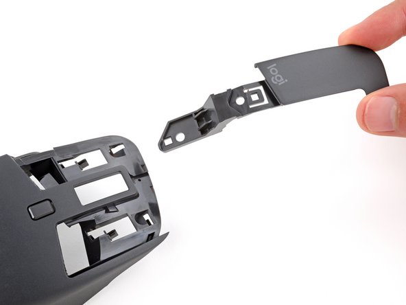

    15. Logitech MX Master 3S Top Shell Replacement: шаг 26, изображение 1 из 3 Logitech MX Master 3S Top Shell Replacement: шаг 26, изображение 2 из 3 Logitech MX Master 3S Top Shell Replacement: шаг 26, изображение 3 из 3
      • Use the flat end of a spudger to lift the battery status indicator housing off its post and unclip it.
      • If you're having trouble, use a spudger to push in the housing's small clip.
      • Remove the housing.
      • During reassembly, push the housing into its cutout until it clicks into place.

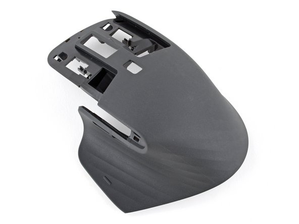

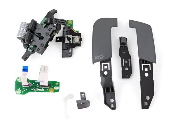

    16. Logitech MX Master 3S Top Shell Replacement, You're left with the top shell: шаг 27, изображение 1 из 3 Logitech MX Master 3S Top Shell Replacement, You're left with the top shell: шаг 27, изображение 2 из 3 Logitech MX Master 3S Top Shell Replacement, You're left with the top shell: шаг 27, изображение 3 из 3
      • You're left with the top shell.
      • During reassembly, you'll need to transfer the parts you removed from the old shell to the new one.
