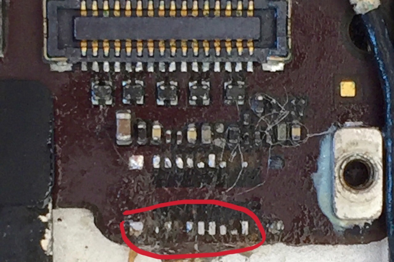

Ipad mini gold pins/pad on logic board missing
Hi, my ipad mini gold plate for touch connector on logic board got missing. how to fix it? thanks
Edited: my ipad mini gold pins on logic board missing

I'm not sure I understand the question. "Gold plate"? This is the touch connector being lifted off the motherboard. Which part are you talking about?

@secondlife sorry sir my bad. i mean this part

Nothing shows at the address you provided, but you can add a picture to your question following these easy steps: Добавление изображений к существующему вопросу
However, if that part in question is a connector on the logic board side it will need to be soldered back in place with proper soldering tools.

IPad mini digitizer connector gets damaged from unplugging the screen by grabbing the long side of the connector. Grab it by the short side and you’ll never have this problem.
once the connector is damaged, it is a straightforward job for mail in logic board repair or your local microsolderer. It is not a beginner job.
once the pads are gone then it is a complex job that is quite challenging, but still doable for experienced microsolderers—although perhaps only for data recovery

this is what i want to know. so i just need to find someone that can do microsoldering. thanks for your answer

Are you talking about the gold pins on the digitizer FPC connector on the logic board? If yes these are fragile and can pretty much break if you are unlucky.
You’ll need to replace that connector through micro-soldering if it is damaged.

yes sir, i think it’s a gold pins. this is the sample

Oh, if it's also the solder pads that have been ripped then jumper wires need to be used to connect the digitizer pins that have missing solder pads under them to make the connection.

it’s look difficult for beginner like me.
anyway thanks for your answer sir
