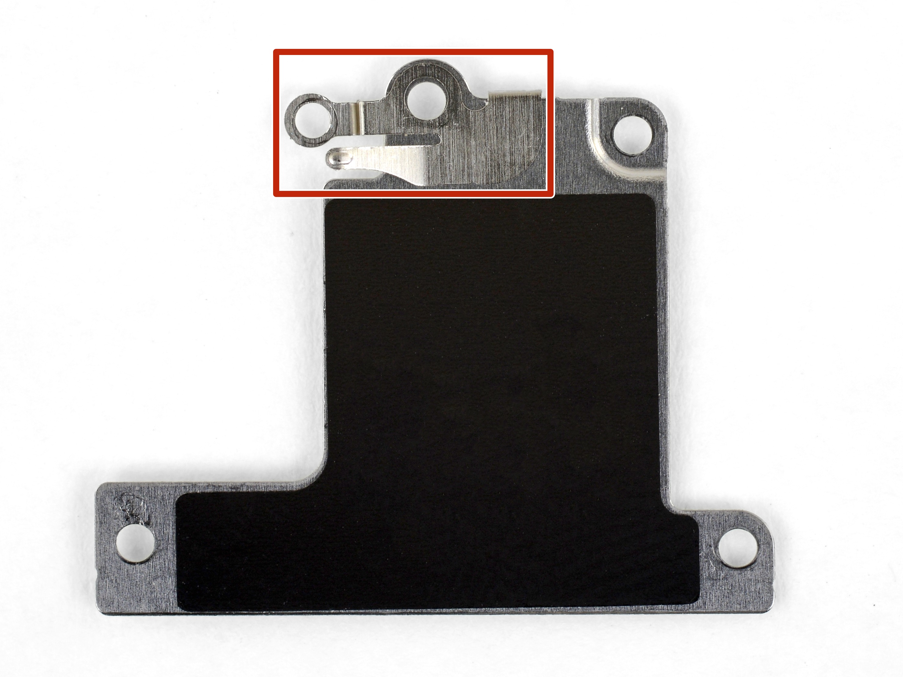

  21. iPhone XR Battery Replacement, Unscrew the logic board connector cover: шаг 21, изображение 1 из 2 iPhone XR Battery Replacement, Unscrew the logic board connector cover: шаг 21, изображение 2 из 2
    • Remove the five screws securing the logic board connector bracket to the rear case:
    • One 1.3 mm Phillips #000 screw
    • One 1.5 mm Phillips #000 screw
    • Three 1.2 mm Y000 screws
    • Remove the bracket.
    • Be careful not to lose the smaller bracket clipped onto the edge. It's secured with a small clip and is easy to accidentally knock off of the larger bracket.

    • The shield is made of two parts, the smaller part is very easy to damage. If broken the NFC of the phone will not function. See comments below for different suggestions on how to avoid damage.

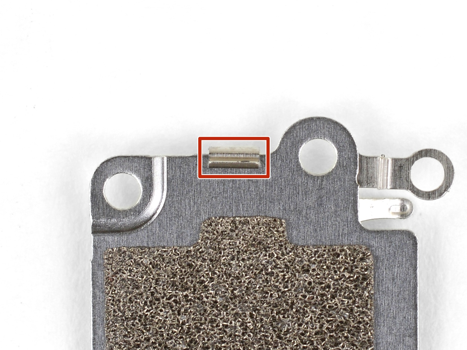

  24. iPhone XR Battery Replacement, Lower Speaker: шаг 25, изображение 1 из 1
    • Remove the seven screws securing the bracket below the Taptic engine and speaker:
    • Three Phillips 1.4 mm screws
    • Two Phillips 1.7 mm screws
    • One Phillips 1.9 mm screw
    • One Phillips 1.6 mm screw

  25. iPhone XR Battery Replacement: шаг 26, изображение 1 из 2 iPhone XR Battery Replacement: шаг 26, изображение 2 из 2
    • Lift the bracket from the edge nearest the battery. Don't try to fully remove it, as it's still connected via a small flex cable.

    • Remove the small bracket on the top right corner of the speaker.
    • Remove the Taptic Engine connector cover.

    • Insert a spudger under the top edge of the speaker near the edge of the iPhone's case.
    • Gently pry up and lift the top edge of the speaker.
    Спросите у FixBot
    Добавить комментарий
  32. iPhone XR Battery Replacement: шаг 33, изображение 1 из 3 iPhone XR Battery Replacement: шаг 33, изображение 2 из 3 iPhone XR Battery Replacement: шаг 33, изображение 3 из 3
    • Hold the speaker by its side edges and rock it side-to-side, separating the adhesive securing it to the bottom edge of the iPhone.
    • Pull the speaker away from the bottom edge of the iPhone until the adhesive gasket separates.
